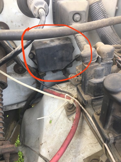

It’s a 5.9 Cummins diesel. So I should be looking at the voltage regulator first? Is this it?
Google Mopar alternator full field test, this should help you test the alternator on the truck
Is THIS it? I put a new alternator and a new battery in it, and the alternator is not charging the battery. I’m trying to figure out what else could be wrong. Step by step. I’m trying to figure out the next most likely reason my new alternator isn’t charging my new battery.

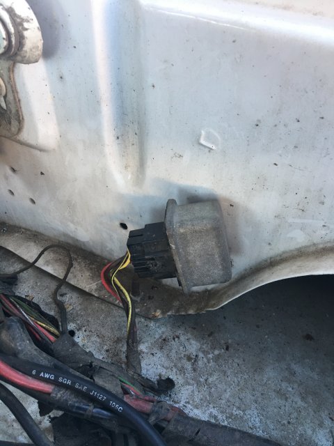

Nope. Look for a box like a post or 2 up, could be chrome or black, about the center of the firewall just to the passenger side of the valve cover
Thanks you guys. Found and replaced the voltage regulator. It seems to have fixed the problem! It looks like it was the original VR. Does it make sense that it probably failed because of age? I think I read that even if you replace the regulator, it could have been caused by a short somewhere else. Should I be worried about that? Or just count my lucky stars that it seems to be fixed, and I won’t be taking it to the shop that was going to charge $250-300 to diagnose the problem? I appreciate your help!
