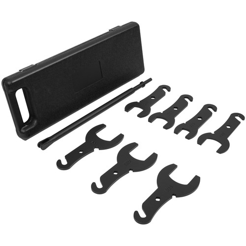

A kit like this, but ours is MAC

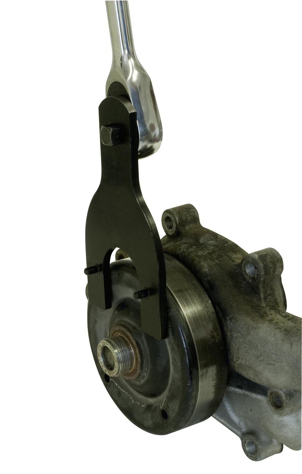

One like this to hold the water pump pulley

I have a set of those and they have worked real good on several later model cars and trucks. Couple of my Dakotas and Cummins too.
