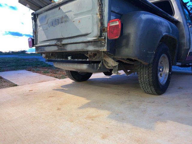

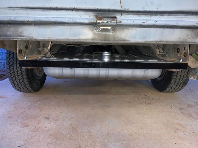

Any one ever installed a mustang gas tank in the area behind the axle
I’m having issues with my current saddle tank and I’m looking at my options in case it needs replacing
I've seen several of the Mustang tanks done. Neat set up.

Other than hard to find, not much issue really. I went thru the with my son's 80. Seems like (late) model year 78, 79 and 80 is all that exactly fit. I found some earlier 70s ones and they were way different mostly with where the fill nipple was molded in. The 81-87 will fit BUT you have to swap a crossmember from the 80s truck along with the tank.
