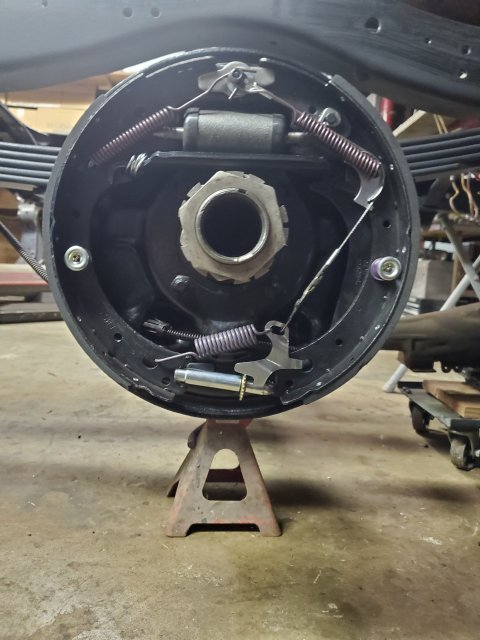

A a68postcar Active Member Joined Jul 23, 2017 Messages 55 Reaction score 39 Location Dinwiddie VA Nov 1, 2021 #1 Here you go boys, Long shoe front or rear???
65 sporty Well-Known Member Joined Aug 8, 2015 Messages 3,267 Reaction score 2,458 Location Kingston, Mi Nov 2, 2021 #2 Short shoe in front, long shoe in the rear
A a68postcar Active Member Joined Jul 23, 2017 Messages 55 Reaction score 39 Location Dinwiddie VA Nov 3, 2021 #3 Winner winner
A a68postcar Active Member Joined Jul 23, 2017 Messages 55 Reaction score 39 Location Dinwiddie VA Nov 3, 2021 #4 Thanks for the reply 65 sporty.

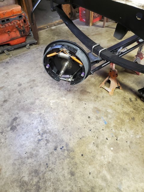

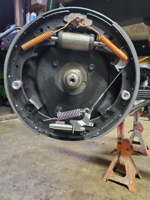

A a68postcar Active Member Joined Jul 23, 2017 Messages 55 Reaction score 39 Location Dinwiddie VA Nov 9, 2021 #7 Moving along Attachments 20211108_175801.jpg 63.2 KB · Views: 178 20211108_175712.jpg 55.8 KB · Views: 178 20211108_175936.jpg 70.8 KB · Views: 178
65 sporty Well-Known Member Joined Aug 8, 2015 Messages 3,267 Reaction score 2,458 Location Kingston, Mi Nov 10, 2021 #8 Looking good
A a68postcar Active Member Joined Jul 23, 2017 Messages 55 Reaction score 39 Location Dinwiddie VA Nov 11, 2021 #9 Thanks 65 sporty. If i can get all the parts its gonna be pretty nice.
