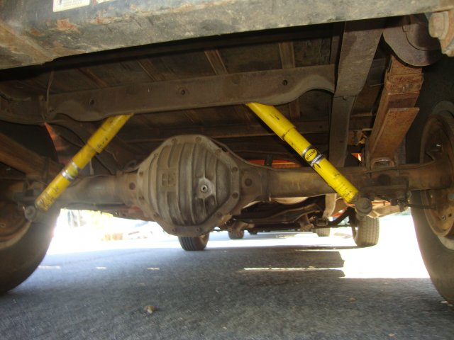

my 64 d100 had a tapper axle type 8 3/4 with3.91 legger . had drum issues , so i swap it out for a 9 1/4 out of a 74 d100 with 3.54's ls it holds up fine with my heated up hp 383 auto .
