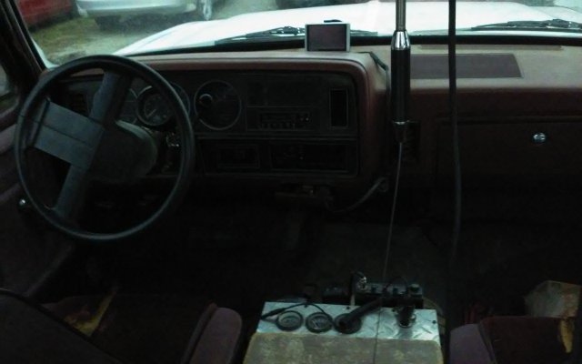

Just checked my photos.
yeah/ im talking about the 2 vents in the dash one on either side of the glove box.
