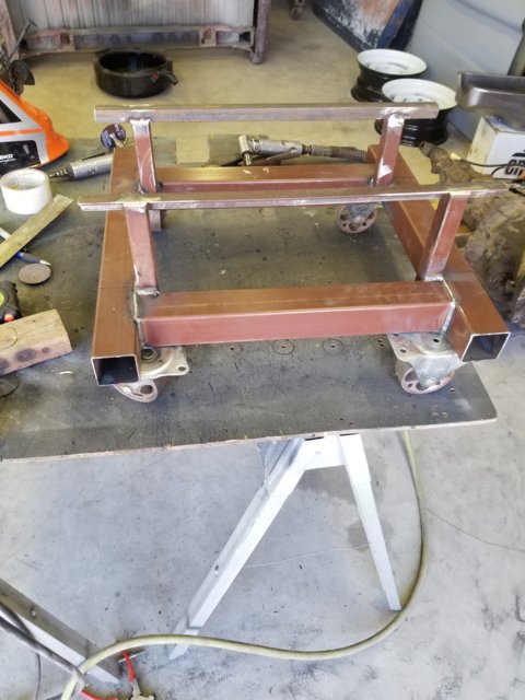

Built this lil number out of scrap tubing and leftover casters
Moparmat2000
Oct 7, 2019
24
34
West Texas

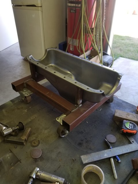

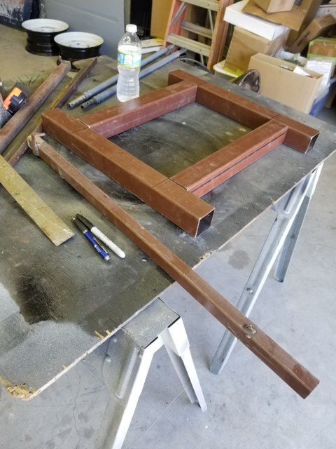

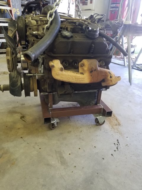

Needed to move that 3.9L V6 I got out of the parts truck. It was still hooked to the chain hoist and balancing with some wood cribbing on the shop floor. I made this to fit a small block mopar V8 oil pan. Will prob cut the welds and move the casters to the front and back a bit more before I set a V8 on it. Took me about 2 hours cutting and welding. It sits pretty stable with the V6 on it though.
Heres pix
