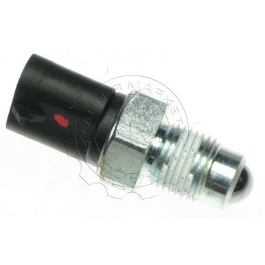

Automatics have them in the transmission they resemble an
oil pressure switch not sure of location on trans,looks like this.
