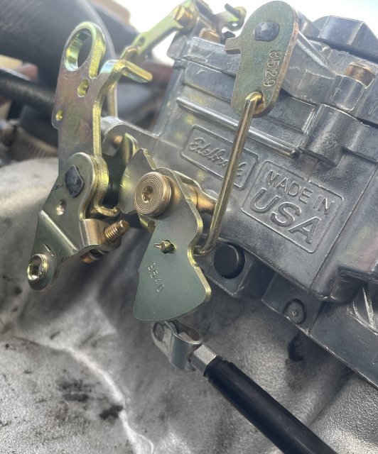

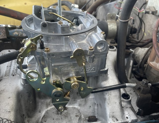

I know you're just a stranger on the internet that answered a question, but could be a stranger on the internet who answers a second question? The question is: how the flippin freakity do I get this throttle cable on this arm??
My photo did not attach for being too large,
They made an adapter bracket for that. I forgot what trans you have/ is it an automatic or a stick?
