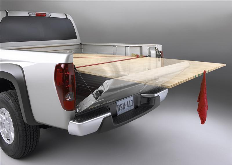

The previous generation Colorado/Canyon had exactly this, a 2-position tailgate that held the top of the tailgate at the same level as the wheel houses in the bed, allowing 4'x8' materials to lay flat. The setup used a 2nd set of end clips on the support cables along with a 2nd pair of attachment posts. I suppose it wouldn't take much to either pull parts from a junkyard or build your own.
