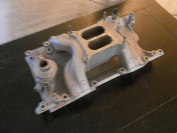

Alright am in the process of buying all the stuff to do the 4 speed as well.
What size carb do you recommend? Stock 5.2 with headers and will be getting a Hughes cam a little later down the road.

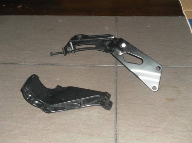

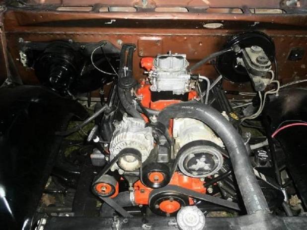

Also If I want to run the serpentine belt but without AC did they ever offer that or will I just have to go into autozone and be like I need a belt thats "shorter"?
Shorter belt yes! Just order for a non A/C application 600-750 cfm carb depending on the cam & gear
