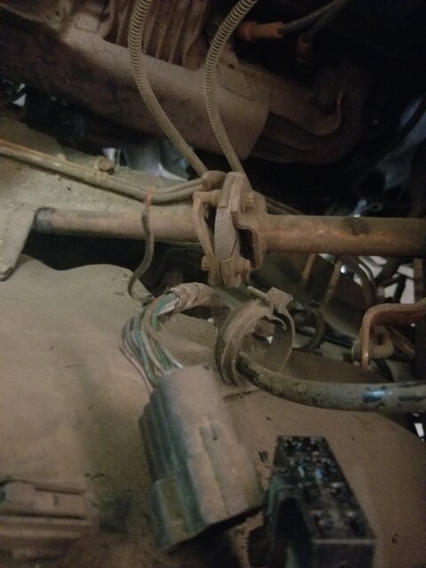

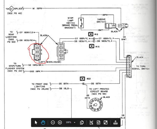

This is the only pic I have on my 'puter, but near top left is a connector that feeds lights to the rear, the connector is supposed to be near the left wheelhouse (underhood).
Hazard, brake and turns run threw the turn signal switch. At least you know that portion is ok.
Yup. The connector just deteriorated. I soldered it. Good to go. Thanks for all the help.
Cool beans. Actually the first one I've seen where the issue is so easily found and you can reach it from above as a bonus. (I usually end up on my back digging wires from between the frame and fuel tank or equally fun spot.) Good work.
