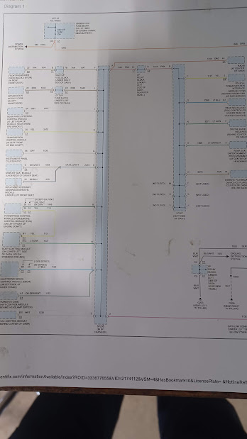

Been fighting this truck for weeks.it starts then dies instantly. Can't read codes odb says can't connect. Changed ignition, fuel pump etc. Repaired frayed wires,still no go
Hooked up noid light no power at injectors. Finally found the splice pack 207, removed it and it starts and runs. Still no connection for scanner. I'm at wits end. Can I just leave the splice block out and move on. Everything is working at this point.
