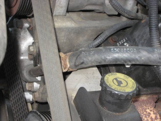

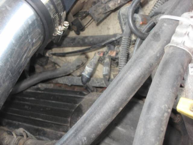

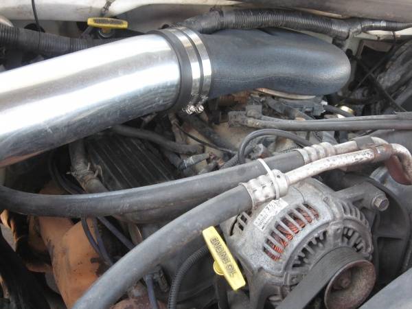

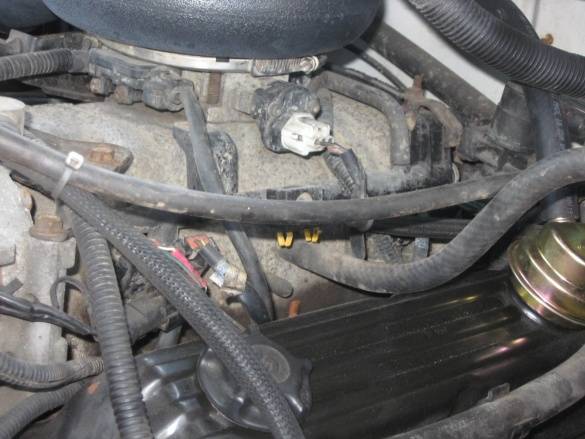

i have a 2001 dodge and i need some engine photo(s)
1 from the passenger side and the other from the driver side ...
more would be great full .....
i am trying to figure out some things due to some wiring
and a water outlet on the water pump .... with the thin metal line ...
thank you for looking and have a good day ...
The only picture I have down loaded of the motor in my Ram is the one in my post ( Aftermarket parts for sale ) . It probably wont help much though , It's a front shot of when I had the short ram on it . If I get the chance I'll try and get a couple of pictures for you . As for the metal line coming out of the front of your water pump (drivers side) , that has a heater hose on it that go's up along your drivers side valve cover , across the back of your engine and then into your heater core outlet closest to the middle .
The one on the top ( like Chuckie said) go's to the intake just under the thermostat .
photo(s) would help a great deal at the moment .....
everything is in and these lil hiccups are holding me back from starting the truck ....
IMG_1818.jpgIMG_1819.jpgIMG_1821.jpgIMG_1820.jpgIMG_1822.jpg I hope these help . I can't really get any good shots of the passenger side because my long horn air intake is in the way . Maaan my engine is dirty ! lol
