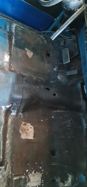

No offence meant but some of the floor pan repairs that seem to pass in the USA would see a vehicle put off the road in AUST. Mine has flat tin welded over the top from the inside and who bogs a floor pan?

WOW what job! Sometimes that's all that's needed to pass Safety Inspection over here. Remember too, that it was probably "just a truck" when the floors were patched. At least the holes for the cab mount bolts weren't covered over. And by the way, I've seen WOSRE floor patches. MINE weren't even fastened to the floor when I pulled up the rubber mat & it was thin steel, like 26 gauge. My truck is just a ratty 3/4 ton, 2wd scrap hauler, but I did buy it from the original owner. Truck has 200,000 miles on it. Your cab mount job should be pretty easy.
