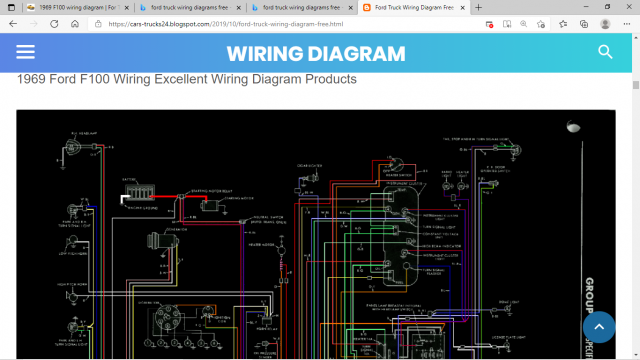

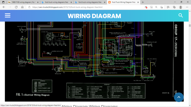

Thanks kiwigtx. I’ve narrowed it down to no power at the brake switch, which is mechanical. One diagram shows power comes from the hot side of the hazard flasher but another one shows power from the hazard switch. If it’s from the flasher I would just supply the brake switch from the fuse block but if it powers from the hazard switch I’m a little hesitant to do it that way.
The power must go through the turn signal switch on the column....due to the brake and turn signals sharing the same 'filament' on the lamp out the back.
If you can get power going through the brake switch - it's either a dead switch, or out of adjustment - then you will be getting closer to the problem.
Now all I have to do is figure out which of the seven turn signal switch wires is supposed to carry power. Without a diagram that’s a big task.
Left hand turn signal - rear - green + orange stripe
Right hand turn signal - rear - orange + blue strip
Turn signals and brake light same wire.
Please verify.....one ping only ;)
'Stop lamp switch' - brake pedal switch - feed from fuse = green
supply to turn signal switch - green + black stripe
I'm sorry but I cannot read the diagrams, they are too small and if I enlarge them they are too blurry to make out.

The colours of the wires should be as I described - if not true, then I suspect the diagrams shown are not correct.
