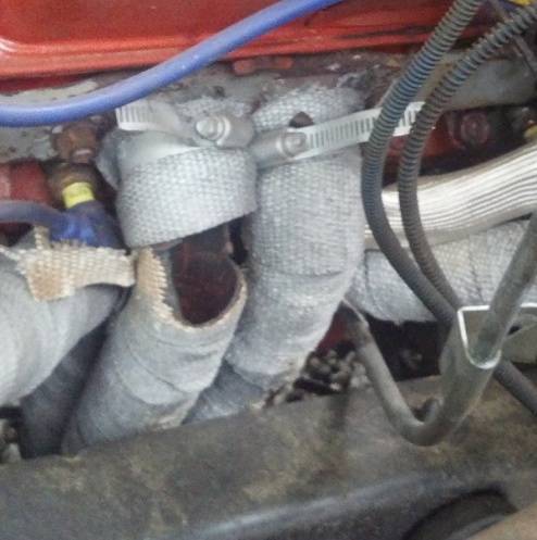

That pic shows exactly what exhaust wrap is good for...
That looks terminal mopar350, I haven't heard anything good about using wraps on road vehicles, it does keep the heat out of the engine bay and acts as a noise suppressor but from day one the pipes start to rust badly and the moisture makes the pipes more brittle.
