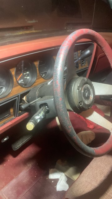

Among the many things on my 85 that were damaged by previous owner butchery and out and out "interference" is my steering column. I went to fix what is normally a pretty easy to fix problem and opened up a hornets nest.
How many of you have experienced the ignition switch that loses its "spring back"? I have and more than once. So I bought a couple of (OLD!) NOS "standard" brand replacements (one as a spare for later down the road as I don't plan to let this one go anytime soon) and discovered butchery off the bat. As in deck screws holding the horn pad. Then to get the nut off and the shaft is mushroomed.
Then to find out the steering shaft "telescopes". And spring tension pulls it out towards the engine compartment end of column. Then missing screws and the plate that holds the turn signal switch in and the 2. (Should be 3) screws buried into the nylon turn signal switch itself. So I either need a pile of parts to fix this one or a different column.

Yup I know about that "spring in the ignition switch" that's what I tore my column apart to fix in the 1st place.
I just got a column from a buddy, another non tilt/ and judging by the steering wheel I'm guessing it's out of either an 81 or 82. My son just bought an 83 d250 that used to be mine, back from my cousin who bought it from me. And the steering wheel is different than this column.

I measured from the flange that mounts to the firewall, to the end of the shaft and it's the same as my original. the spring on the beginning of the shaft, where it protrudes from the bottom of the column, seems "longer" than that gap on the replacement I have here.... and the arm that the shift rod snaps into seems to be a bigger gap on my original that "closes up" if I pull up on the steering wheel. I figure that is from whatever the ham fisted idiots who were previously in my original column did to damage it.....because that shaft which shouldn't telescope, does? and definitely seems "spring loaded" That gap by the shift linkage arm on my original, does close up when I pull up on the steering wheel.

I had to partly dismantle the column from my buddy, to replace that ignition switch and to clean it up for paint.it was bare in an arc around the key switch like so many of them get.
The upper bearing was also rusted tight from sitting so I took the upper most steering column collar from the original column. that bearing was one of few upper internal parts that were good from the original column. On that upper collar were date codes. The column from my buddy had the clock/date code thay said 82 and 83. The original said 84 and 85. So given the interchange info I've seen from the online junkyard listings I saw that 82 definitely was offered as the same. Wasn't sure about 81 which was what I thought this replacement was.
Otherwise the replacement is complete with no missing parts and no home made "telescope" function.
