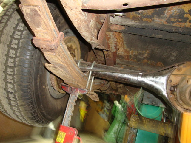

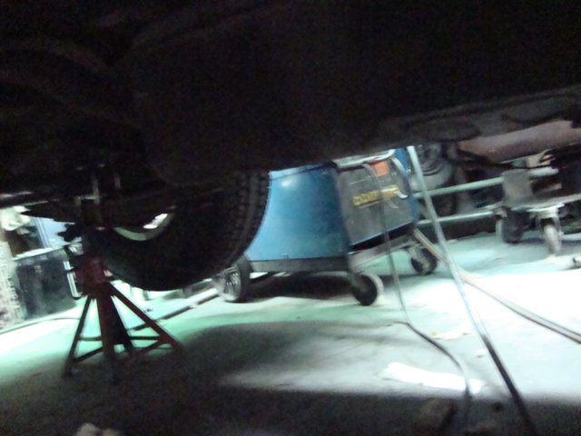

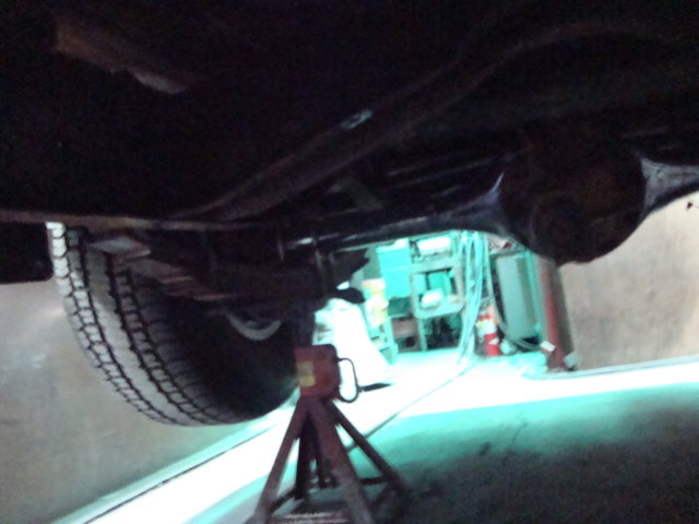

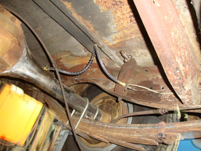

this was my way to bring it down , but still have a truck, its still not gone . those rears are 315/60x15 on 8.5x15 .

Thanks for the pics, that helps. I read the front spring perch also but the rivet holes are not straight. I just didn't know if drilling holes was the correct way or if I was missing something. My math says if I flip the rear perches I'll get 4 inches of drop and will level out to the front measured at the body line. To measure the pinnion angle the drive shaft has to be out, correct?
I lowered my 77 by raising the perches on the frame, I cut the holes with a plasma and used grade 8 hardware to bolt the perches on. It was enough to level the truck with the tired front springs.
