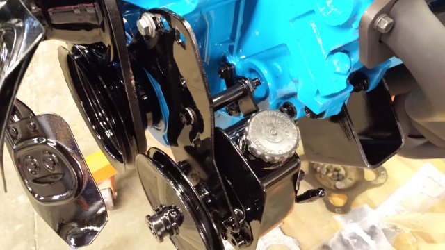

Here is the small block P/S pump setup.
Thanks for the info, It's really nice! Rattle cans look ok, but don't hold up. I'll have to get some and shoot it. Thanks
Ya I stopped using the rattle can stuff a few years ago. This stuff withstands fuel, heat and such so much better and will last much longer.

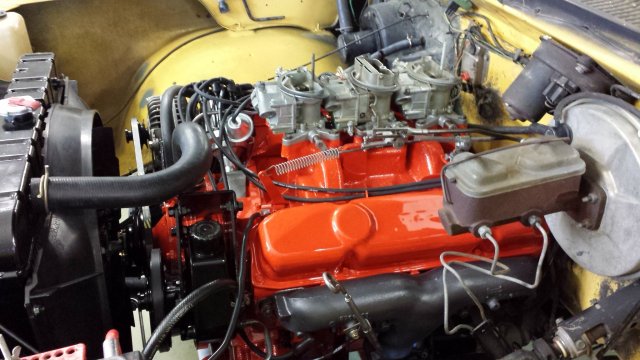

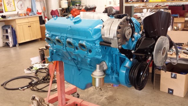

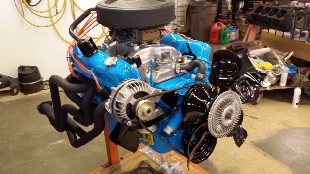

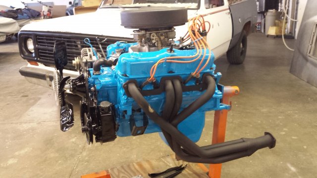

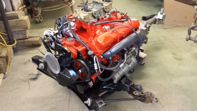

Here is the 5.9 Magnum in my Dart and a few more I've done.
