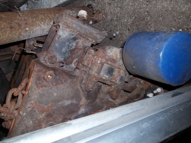

Is someone looking for lil ole me ? :confused: lol And thanks for the faith or confidence it sounds like you guy's have . ... Now I know there a ton of questions and a lot of them have been answered already . Since your "just" asked about the brake booster . You need the small one and you don't have to spend big money getting a special one from the aftermarket . You can get one from your local auto parts store . Have them look it up for either a mid 80's 3/4 ton truck or a mid 70's big block truck . Just make sure it's the small one. If you want I'll get you the part numbers . Also , I'm not sure if you know yet , but the booster is going to have to either be pulled out and tied to one side during the install of the motor or installed after the motor go's in .

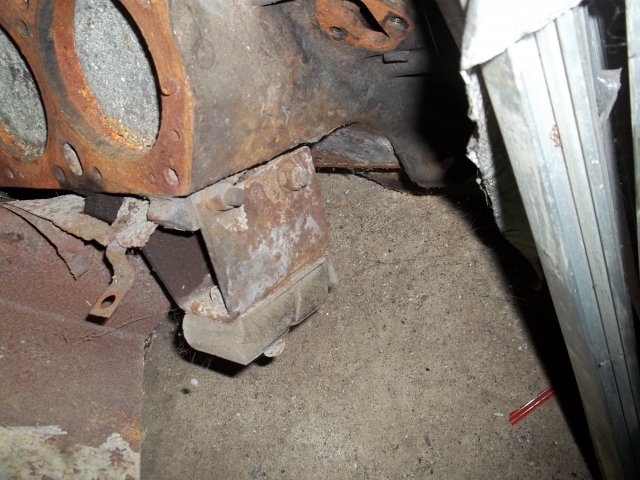

The big block mounts are the biscuit style . Similar to the A Body 340 mounts but are thicker . So make sure you use the truck mounts . If you can't find them then let me know and I can get them from my supplier . On the K frame you "should" be good but I'd have to see it . A lot of the slant 6 trucks had the same K frame and they just added that banana shaped mount on one side to bolt up to the six .
I'm pretty certain he did check the crank to ensure it was deep enough but I'll have to double check on that. Regarding these biscuit mounts what do they look like bear?

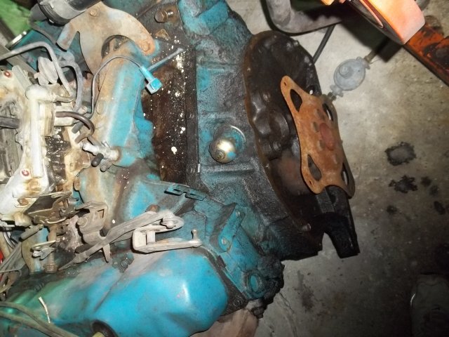

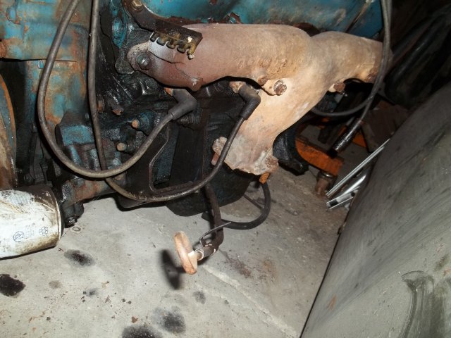

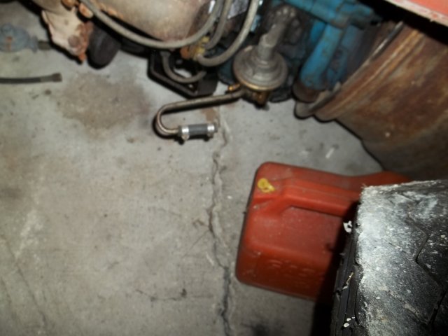

The ones that are on the engine are shown here. Are these 4WD only mounts?
I have another engine that has slightly different mounts. Are these the correct ones for 2WD?
The first ones are 4 wheel drive mounts . The second post look more like them . Not the greatest picture , but can you see the mounts on my 440 ?
I didn't think I still had this on file . Here's the two wheel drive big block mount brackets .

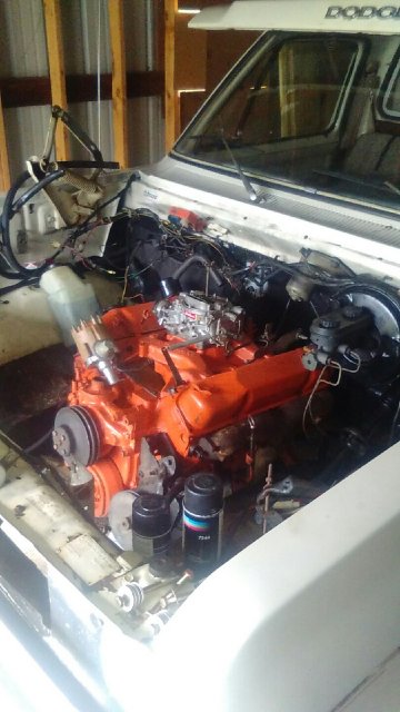

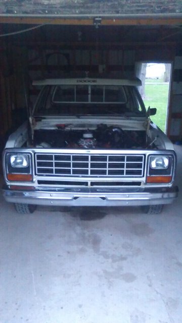

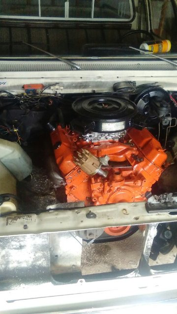

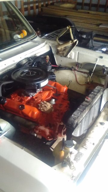

He got it in yesterday actually. I'm a couple hours from him so I wasn't there. The mounts that were attached to the engine in the first pics worked.
I'd love to see a shot right along the left valve cover to see the booster clearance. I've always heard the small booster was necessary w/440 but maybe it appears it may be more of a convenience thing.
Naw it is touching he said. What year are those smaller diameter boosters and what did they come on?

Actually he's told me it's not touching after all, my mistake. He said it has about 3/4" of clearance.
