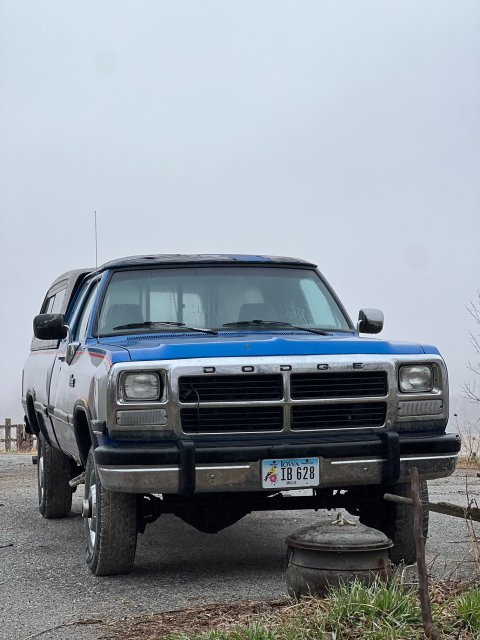

Hello! I have a 1992 Dodge ram W250. When I seem to go over a medium-sized bump or pothole in the road. My truck starts to violently shake, Then it straightens itself back out if I yank the wheel, Now with that being said it only seems to happen under 40mph. As ive reached as low speeds as 15-20-25. But any higher above 40 it doesnt do it over those same bumps, I don't know what to do or replace on it. Anybody had this issue?
