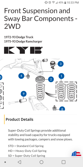

Would any body here know if the spring isolators from a 2nd gen 2wd will work on a first gen 2wd? I have an 89 d100 and i can not find this part (part number 2). have everything else to rebuild the entire suspension and steering. Lmc wont have any for at least 10 weeks. I can find them for the 2nd gen though. Are they the same or at least close enough? Thanks in advance.

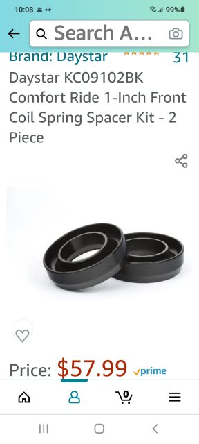

Use these, I just put them on my 81 frame last week,fit like a glove!
I just noticed those parts say 1 inch level spacers. Did they lift the front end up?
Yes, not much, probably between 3/4 inch and a inch, which I needed in my case because I had lowered the front end too much and needed some fender to tire clearance.
