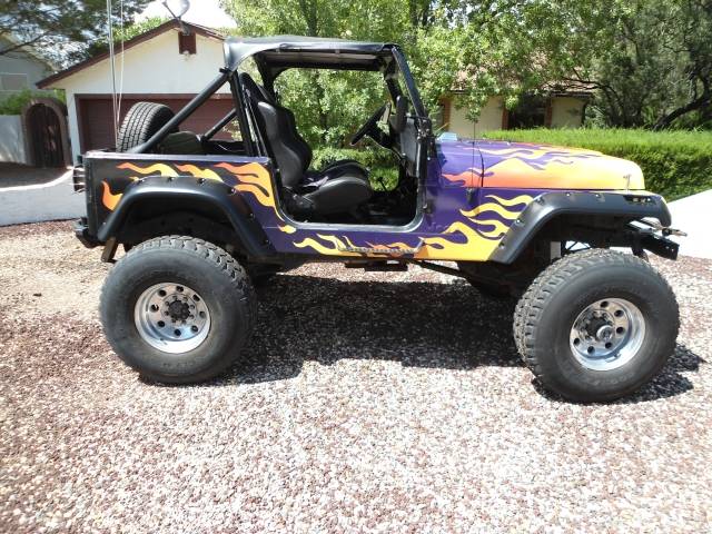

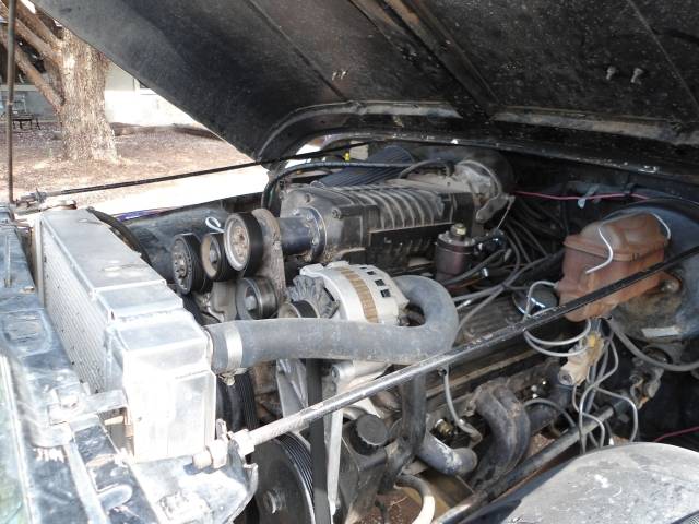

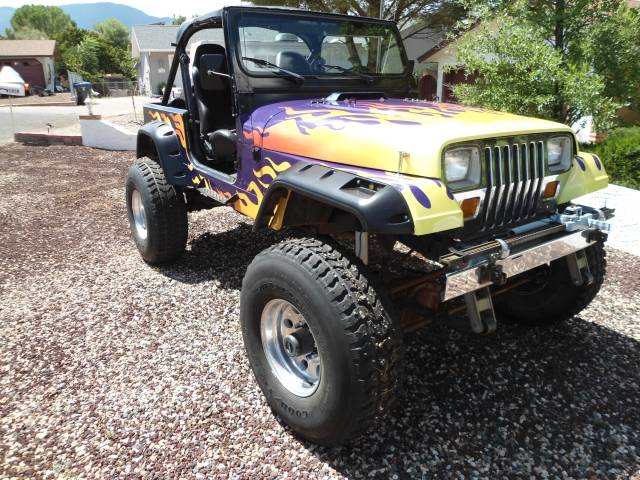

This is my hotrod Jeep. It is basically a SHORT 1 ton Chevy truck with a Jeep body. It was created with a 1995 1 ton Chevy truck for the engine, trans., axles and springs.

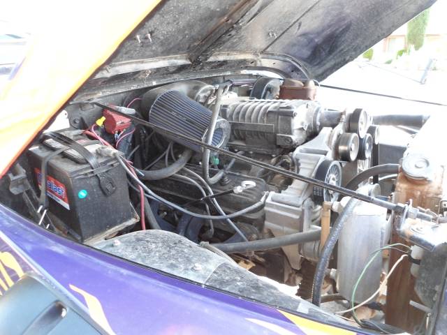

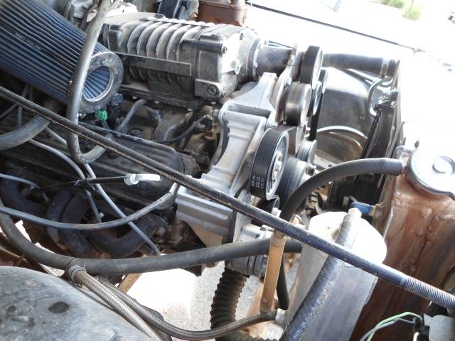

It is a 350 F,I. with a Whipple supercharger.
350 turbo hydro trans with B&M shifter.
16.5” inch wheels and 37” military tires.
Dana 60 front axle with Spartan locker and 4.56 gears and front locking hubs.
Full float 14 bolt rear axle with Detroit locker with 4.56 gears and disc brakes.
NP 205 transfer case.
Custom Advance Adapters aluminum radiator with Spal thermal fan switch.

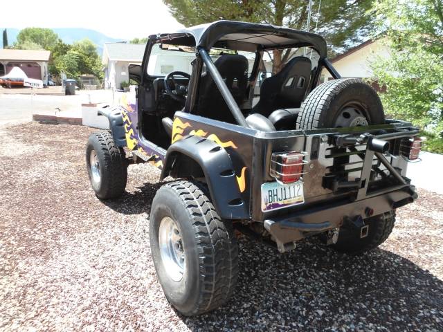

Hardtop and Bimini tops.
Full removable doors with roll up windows.
This Jeep will crawl up a wall.
