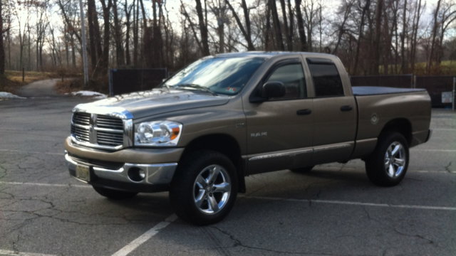

My unrestored but no rust original owner 92 D150 s/b 2wd stays in the garage or enclosed trailer for the winter and doesn't see rain unless stuck in it while out. My 08 H.Q.C. isn't driven daily and only used to tow my race car and get around when it snows a lot even then it is taken to a car wash that does underneath asap. I recently repainted the frame with black Rustoleam and the holes above the wheels in the inner fender have been filled with silicone sealant to keep the moisture out so it doesn't rust like so many trucks like mine have there.
Not a drain hole , on each side there are three oblong holes in the inner fender that are open to the outer fender these are the holes I filled with silicone sealant
