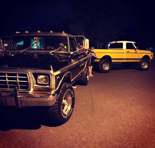

So i've got a 79 f250 Ranger Lariat Camper Special edition i'm in process of restoring. has factory dana 60s front and rear 3.55 gears, 4 speed right now has a 460 in it but have the original 400. I've got some options i''m trying to figure out enginewise. I have a 460 block, the original 400 block and also a 351 windsor block. in the end i plan on having 4.10 gears, a c6 auto and whichever engine i end up building running 35 inch tires. What would you guys do? I want it to run pretty hard and if i do a windsor it will be a stroker as well. Also want to be able to run 10mpg at least haha when normally driving that is. im getting 7 with the 460 im running RN
Sounds like a fun project. We'd love to see some pics of course, doesn't matter the shape.

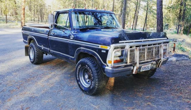

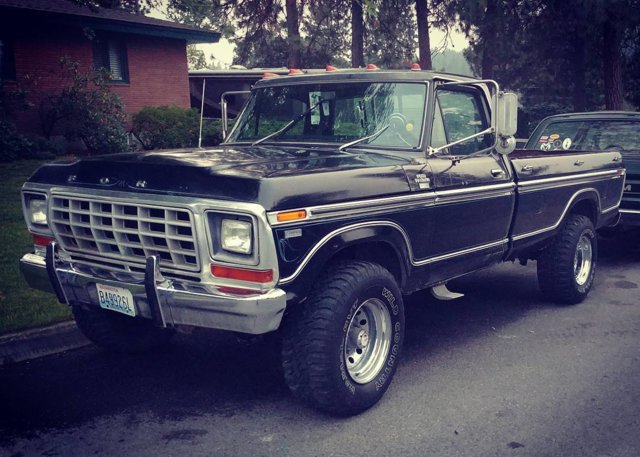

has hubs up front. has no real rust just worn out
That's a sharp truck, grew up with those still pounding the pavement as a kid, left an impression. I'd stick with th 4 sped,but that's because I have an auto in my truck and it would be cool to have a stick, until I have an old school stick that's got a nice hard pedal. My cousin had a 400 in his Bronco and it went pretty good. Don't remember the gears, want to say 3.73's but it was 20 some years ago. Parts are available for whatever route you choose, I'd think a small block could get you the power to want and be a little better on fuel than the 460, but the 460 would pull some serious stumps.
