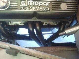

A friend of a friend let us test-fit a set of Hedman 79080 headers (application says 1975-1979 Dodge D100) - they fit (minor mod for steering linkage clearance likely) - here's a pic of the test-fit:
