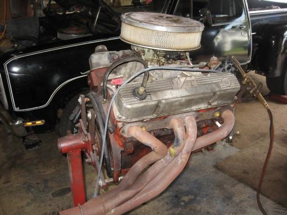

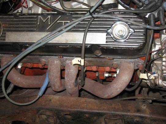

IMG_3007.jpgIMG_3009.jpgYah , With the motor home heads I think you have more clearance with the plugs . You would think a simple thing like spark plug clearance would be straightened out in the design of the headers . But noooooo ! lol Might not be the greatest picture but here's an idea of what I had to do to my headers on the Warlock . I'm just lucky I had another big block on the engine stand . Otherwise it would have been in and out of the truck a few times . ........... Over the years of running headers on almost everything I've owned , I've found using the mini starters almost a must now . There away from the heat of the tubes , easier install's , and if you ever have to pull or change the starter at any time , It makes it a whole lot easier . Hell , I even run one on my Ramcharger and that don't even have headers . "yet" lol

Yah , The mini's definitely make life a lot easier . I think they draw less current over the older style as well . I'm just glad I had that 383 on the engine stand when it came time to work the headers for my truck though . R & R'in headers on a big block truck isn't fun to begin with . After marking all the tubes , I heated the area's with a torch and indented them with a piece of steel pipe and a hammer . I didn't want them to look like I just pounded the crap out of them with a sledge . Like I've seen so many other headers were done .
