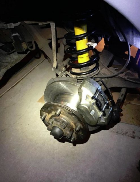

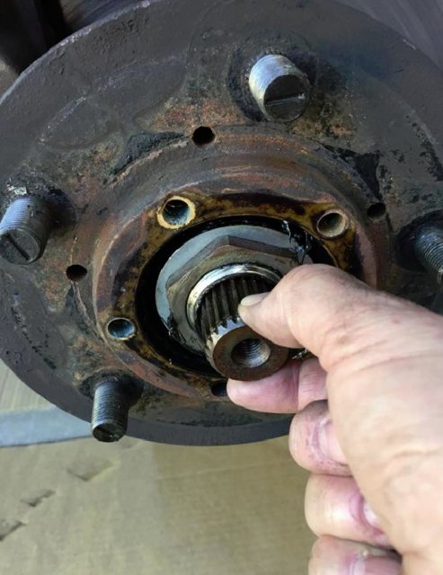

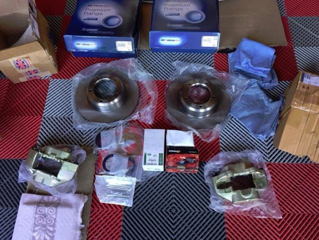

    I just did the front brakes on my Land Rover a few days back and honestly I'm still recovering. It was about an 18 hr day on that, as there was SO much more involved than on a car. The rotors were bolted to carriers meaning the bearings etc all had to be removed to replace the rotors. The closeup pic showing the bolt, there were two with washers then the bearings (not exactly light duty looking either) behind that. Part of the crazy time was running for more stuff, mainly bearings which at 130K mi seemed the right thing to do. I wonder if all trucks front brakes are like this (I was a car guy long before I got into Land Rovers) or if this is a sign of it being heavier duty than say a 1/2 ton Pickup.

    If you look at most trucks and compare the 1/2 ton, 3/4 ton and 1 ton you will find the brakes, bearings and most suspension pieces get larger as the weight rating goes up. The rover stuff doesn't look any beefier than a 1/2 ton

    Interestingly, I have had experienced mechanics say it looks build like 3/4-1 ton trucks. Hence my asking. I get how springs and load capacity are basic rating purpose but the drivetrain has other stuff beefier as well and that's what stuck in my head after hearing unsolicited comments from experienced mechanics (one that own 3/4 ton diesels) say things like that.
