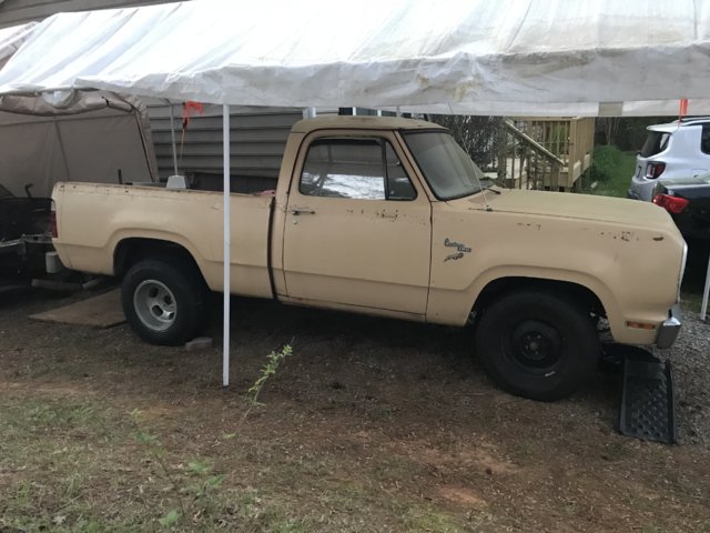

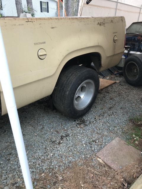

I got the wheels today (brand new) only to find that whoever first installed the center caps cross threaded the screws that hold them to the wheel. I returned those two wheels and I’m waiting on another two. In other news I tried to start the truck today only to find that the fuel tank is filthy and is in need of cleaning. I removed the tank and then found a large crack(s) on the top and side of it. Not sure if someone reproduces the tank. Maybe I can get by with the auxiliary tank for now ( truck is a dual fuel tank truck). Oh and here’s a pic of the wheels on the rear. There not the best pictures. Will take more once the new wheels arrive.
those look great!The old slots are hard to beat. I'd like to score a pair of the wide Trailduster wheels for the back of mine to fill up those big fenders.
