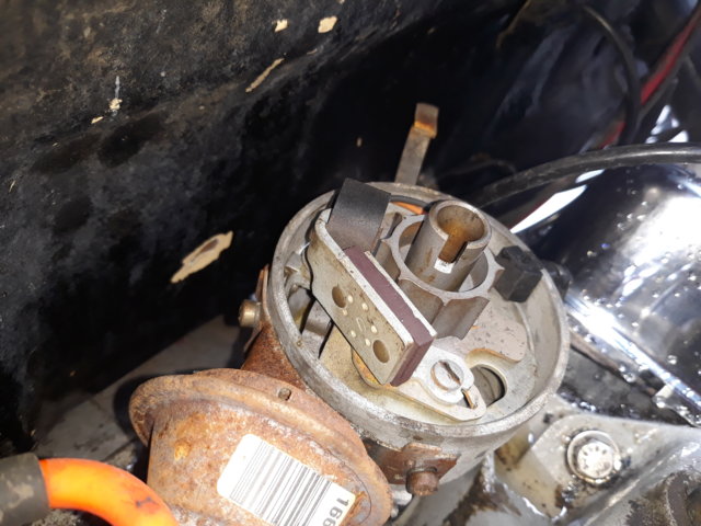

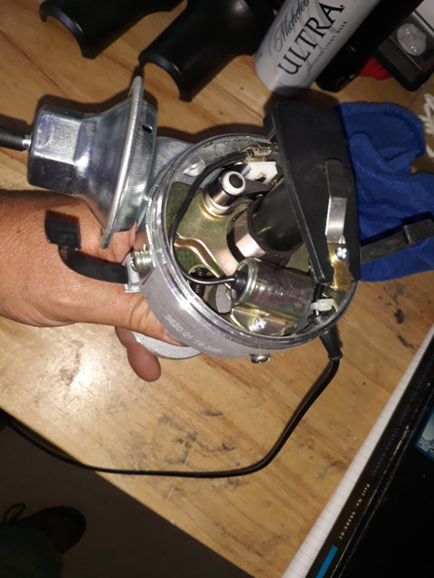

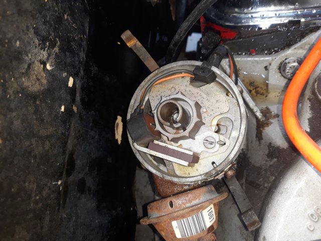

Ok, Obviously the motor has a add on electronic ignition, the distributor itself wobbles when its running, thinking bent shaft. My new RockAuto distributor is points style. My question is, does anyone recognize this brand of electronic ignition? Then hopefully I can find a install instructions to convert the new distributor. Thanks for any help/advice. Not well versed in ignition/distributors so this is stressing me....
Disconnect the negitive coil wire and hook the new distributor to it set the point at about .017 and forget the conversion.
The old distributor looks to be an original Chrysler type.
Some swear by distributor conversions. Other have nothing but problems. If you want one like you took out just send the new one back to Rock Auto and have them send an electronic unit for standard Chrysler electronic Ignition.
Ok, sounds like good sense to me, the new one has one black wire coming out of it, the old one has two wires, one orange, and one black. Do I go black to black and cap off the orange wire? Sorry for the newbie questions....I will learn. Thank you.
Forget the original distributor wires exist and hook the wire of the new distributor to the negative coil terminal after removing the wire that is there. It's that simple. I have done the swap along side the road many times it's that simple.

Is there a ballast resistor on the firewall? The original coil is designed to run on reduced voltage the ballast resistor provides.

There is a resistor on the firewall, I ordered the correct electronic distributor from RA, going to keep the points style dist. as a backup.

From the looks of the distributor his blast will work just fine. If it were lean burn thats a complete wireing change.
