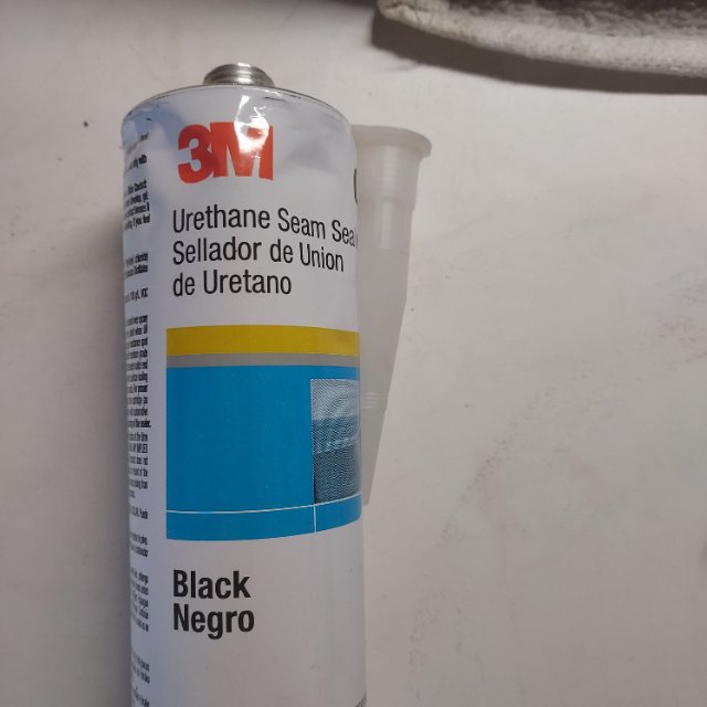

I use 3M seam Sealer 08367. Has a shelf life so do not purchase until ready to use.
