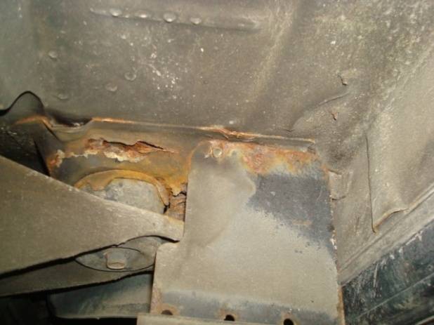

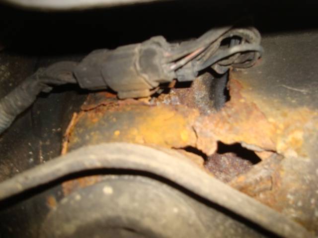

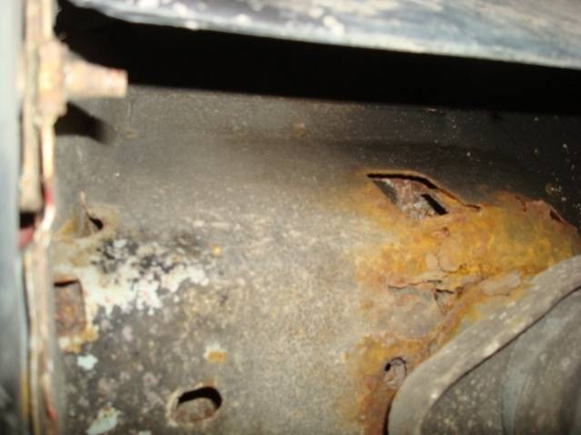

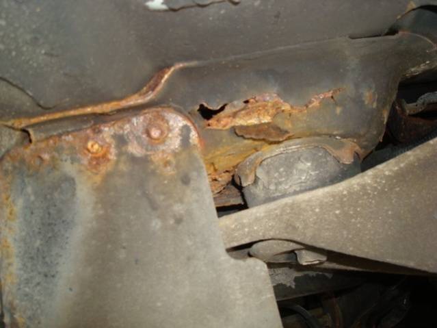

Which mounts are bad? Are the mounts collapsed or pushed into the floor?Pictures would be great
The front cab mounts have rusted and are collapsing. The floors are still solid
I pulled over a 25-30' cedar tree last year and that is when I noticed the shifter was difficult to get in park. A would guess that is when they started to collapse.
I was hooked to the trailer hitch but had to pull hard to get the tree to come over. Guess I should had videoed it since the little tree the guy pulled over with his cummins got so many hits on utube...... LOL
Might try and get pictures today

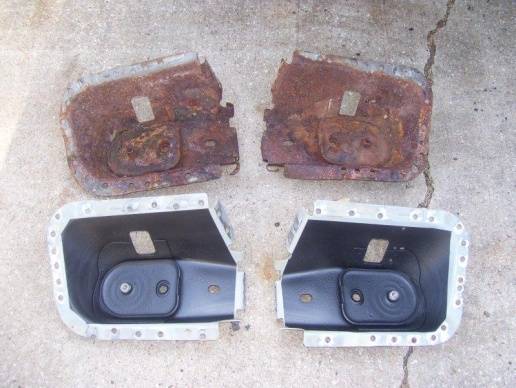

This is not a fun job... I replaced all of my cab mounts on my 1997 2500 when I was doing the frame off restoration. Having my cab completely off the frame on stands did make the job much easier to do! As you said this is a common problem on 94-02 Dodge Ram trucks... Unfortunately Mopar has discontinued the mounts and no one is currently reproducing them. Your best bet is to call a southern salvage yard for good rust free ones as I did. Here is a good link for searching salvage yard inventories.
http://www.car-part.com/index.htm
I found mine at a yard in Georgia. They had all six mounts cut out and shipped to me for $475. I used a spot weld drill bit to remove the unwanted cab floor that was still attached to them. After that I soaked the cab mounts in evap-o-rust to be sure they had no rust hiding in them. Finally I painted the inside of the mounts plus coated them in bed liner before welding them into my cab. You can see my original front mounts with their replacements below.
http://www.fortrucksonly.com/truckf...ave-Changed-20-Years-Ago!-1994-2001-Dodge-Ram
left cab mounts
right cab mounts
