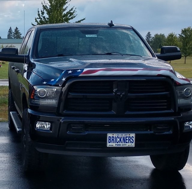

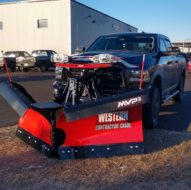

So, as much as I loved that Power Wagon, I decided to trade - again. I work at a Ram dealer and had just cleaned up a 2014 3500 6.7 Cummins / single rear wheel. For the age and miles (123,000) it was especially clean. It had been corporate driven and faithfully serviced. So, it was out with the new Power Wagon and in with the older 3500 with the factory heavy duty plow prep package.

That thing should move some serious snow.
I'm hoping it will and it should. Western recommends 760lbs of ballast in the box and it needs it. While driving home with the plow on the first time, I only had 500 in the box. While going around a curve, I hit the loud pedal a little too hard and the back tires quickly lost traction. I've seen guys try to plow without ballast and are continually having to get pulled away from snow piles.
Thats all 750 lbs. ? That like throwing a feather in that 3500. Surprised you don't carry at least that all the time to keep that beast riding smooth.
