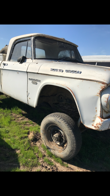

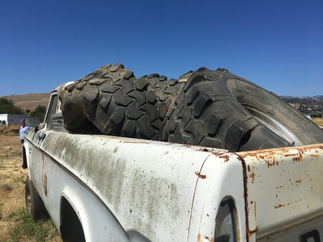

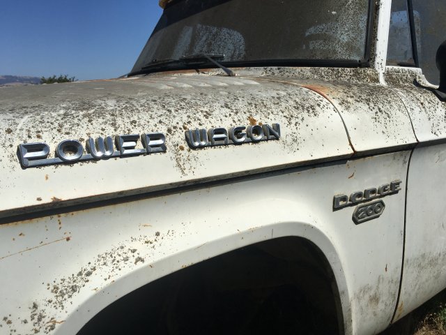

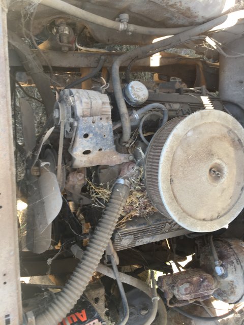

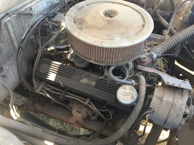

Hello this is my first project and I’d like to get some advice. It’s a 1967 dodge 200 power wagon with a Chevy small block 350 in it. Already has a lift big enough to fit 44 super swampers on it. I would like to get it running then turn it into a off-road mudding rig. Any advice for getting this baby running again or things to modify? Thanks
I replied to your other thread on what to do to get it started. Nice project. Looks like a mid 70's to 80's small block. What trans?
Yes thank you very much going to try those steps out as soon as I can, I’m not sure if I can turn it over by hand (I’m currently away from it right now) as for the trans I’m not sure I gotta take a look. I’ve been considering if this would be worth restoring. I’m not sure how much this will all run me as I’m on a budget, any idea what you think it will take? Thanks for your time

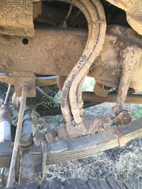

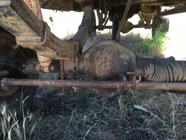

First thing I would do is clean the undercarriage to see what you're
faced with as far as any frame
damage, dried out or damaged
rubber parts, bent or broken
suspension parts. Secondly,
check to see if you can turn
the engine over (by hand if you
have to). If it won't rotate, you could
be looking at a rebuild. Third, this

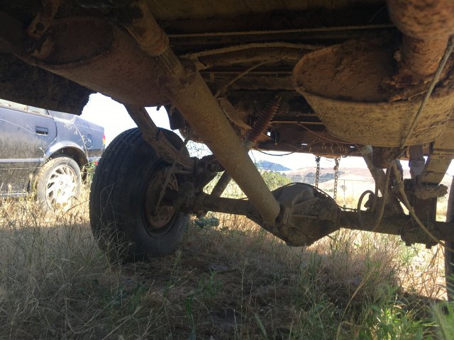

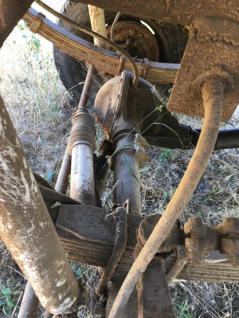

is obviously a 'back yard' lift. The
u-joint angle at the rear diff is
going to be eating them on a regular
basis. The spring pads will have
to be cut off, and new ones welded
on after the diff is rotated. Fourth,

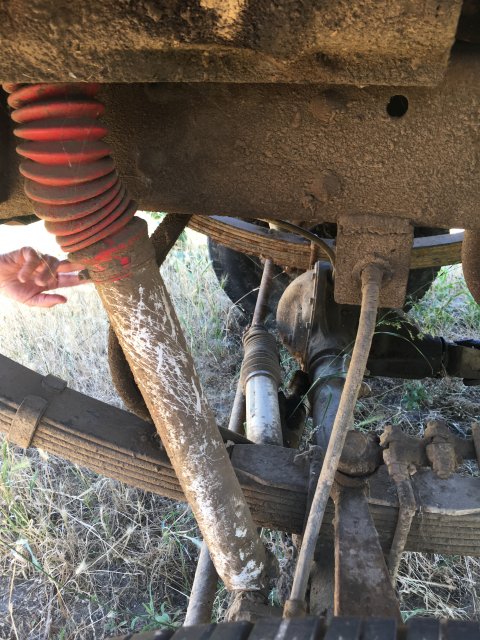

it looks as though the shocks are
limiting jounce and not allowing
the rear tires full travel. Those rear
brake hoses already look 'tight',
and the driveshaft looks like it
wasn't modified to compensate
for the added lift.
And finally, I would ask the owner
why it's been parked. It could have
transmission/transfercase issues.
Anything you find in this condition
can be set up to run and drive but
will depend on your budget and
the time involved.
