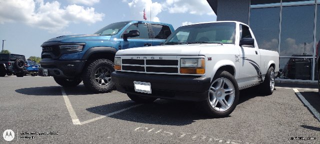

Looks like you came to the right place, lots of help above. I'm back buying, fixing, modifying and selling 1st gen Daks so I'll be on here more. Will have a nice 95 for sale soon. pic of it last summer, looks a bit different now with new chrome bumper clears up front and fender flares.

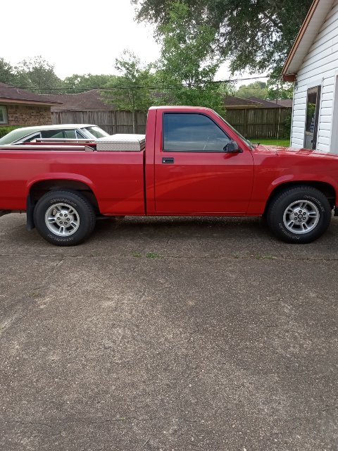

I have 1st gen 8" Durango wheels on my 96. Would post a pic but don't have any on this puter...
15 & 16" X 8's look pretty good but I like the 17X9 RTs a bit more. ;-) Little bit of work to get em on and not waste the rim though. Have 16's on my 93 but no pic on my phone..

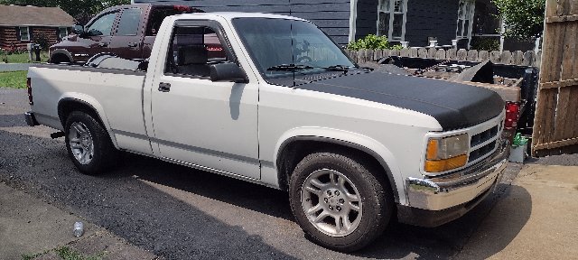

My 93 with 16's. Hopefully soon to have race weight 15's.
