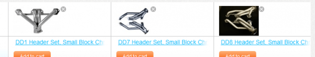

Thanks Dogs! I see that they have two basic styles - one has very short tubes that dump in the center of the block, and the other has longer tubes that dump behind the rear-most exhaust port. Which dod you choose?
I got the DD1, the ones that dump in the center. I bought them from another retailer, they were on sale for $100.00 below list.
Sanderson does not use a header flange gasket. Instead they use a bead of high temperature RTV sealant. Just follow the instructions. It works! Got several hundred miles with these headers and no leaks from the flange.
Like I said, earlier, the paper collector gasket blew out quickly. I now run the copper gaskets. No problems.
