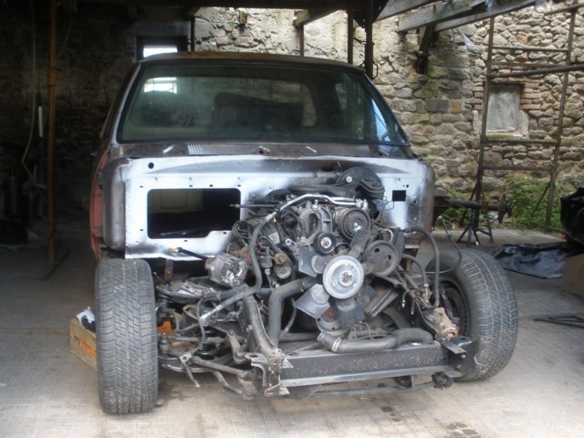

I did Dakota spindles and JDM lower control arms. Not sure if they still make them. Lowered about 5 inches in the front. You can see it in my thread.

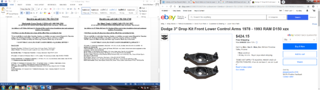

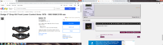

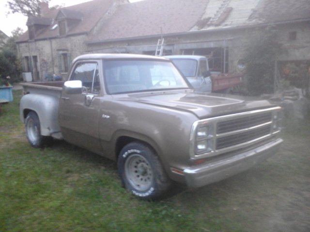

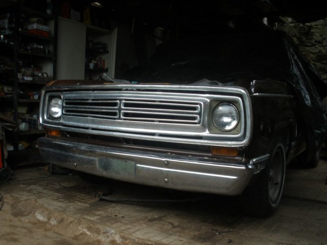

These are what i have.

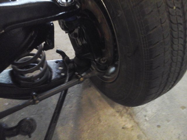

In my opinion they are overpriced. my first truck was lowered with B vans LCA and a rear axle flip still happy with the ride and the stance. New excentred bushing for the upper arms. like to get tubular control arm in the future. Went with dropped dakota spindle on my 73 d100 frame because of OEM front drum brakes????. Front disc brakes were so hard to find locally..

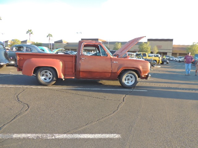

I assume these lowering kits are from Bell Tech. I talked to John, one of their tech advisers, who said NONE of their kits will work on a '77 D100. But that PU in your photos has the look I'm wanting.
Nope bought the dropped spindle and short front springs on fleebay motors. check the website Most of the parts used for lowering are standard/ OEM MOPAR parts. Disc brakes are from a 75 new yorker, Bearings from an early Dakota brakes calipers from a 76 D100. Strut rods from a B250 . Rear springs hangers and u bolts from a C body as well as rear shocks bought lowering shackles and spring perches from a friend of mine.... Just scrounge in your local swap meet you will find a lot of good spare for your lowering conversion. it what was done.

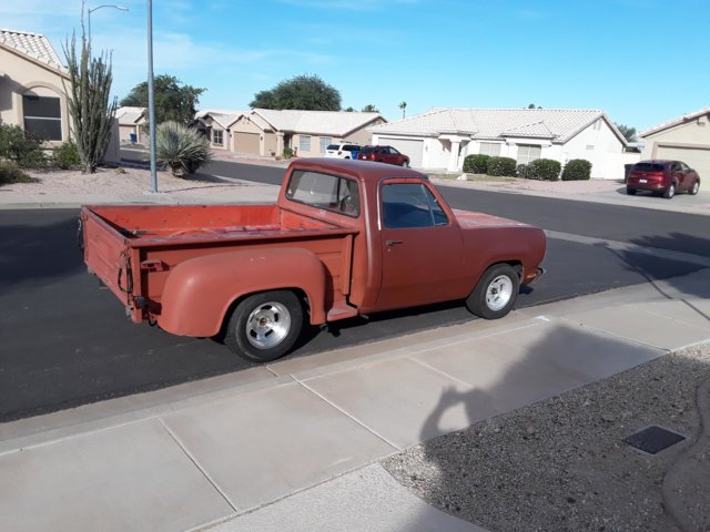

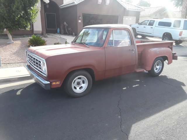

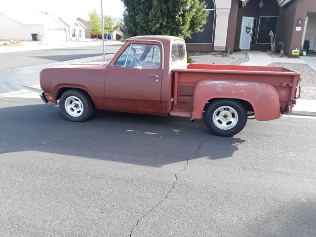

Just did mine. Went with the van lower control arm. Dropped about 2 inches. Did an axle flip on the rear. Replaced the 9 1/4 with 8.75. That dropped the rear about 4-5 inches. I need to raise the rear a bit to get the look I want. I could also go with 91-92 Dodge lowering springs since they are available. That would drop the front another 2-3 inches.
Dart4forte, like your truck, ‘78? Starting work on my ‘78, your truck similar to mine. I’m new at suspension changes, what year for van LCA? Anything else that needs to be changed when installing van LCA? Original height springs? Shocks stock length? I don’t plan on big drop, maybe 2” front and 4” rear.
Non-related questions about your truck - what size engine? Fuel cell? I noticed that gas tank filler is gone. If fuel cell, is it mounted between frame rails where spare tire is located? What size are tires?
Many thanks to all!
Many thanks to all!
The LCAs are 73-79 van, dropped about 2”. Only other thing I did was freshen up the suspension.
The rear I did an axle flip, 9 1/4 went away for an 8 3/4. That dropped the rear 4-5 inches.

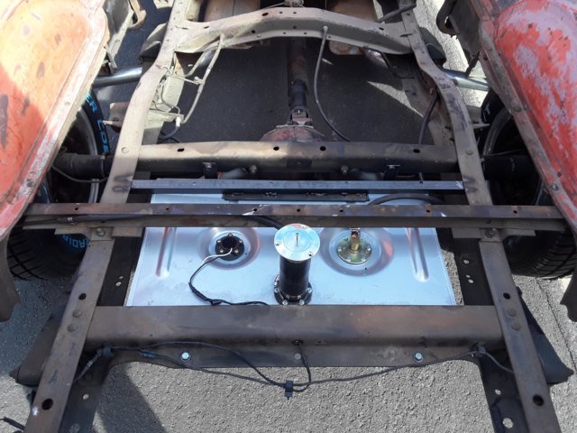

Relocated the tank to the rear. Used a universal Tanks Inc. 16 gallon tank
