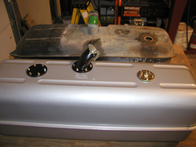

So, I decided to give this a try and install a brand new CLEAN tank in my '53. I ordered the 39DP-T tank from Tanksinc. When it arrived and I unpacked it I was immediately impressed with it. This tank is very well made with heavy gauge steel. It is designed to replace the original '39 thru '47 Dodge tank but has some modern upgrades such as a built-in sump for an electric in-tank fuel pump in case you plan to go EFI at some point. Nice!

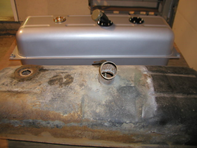

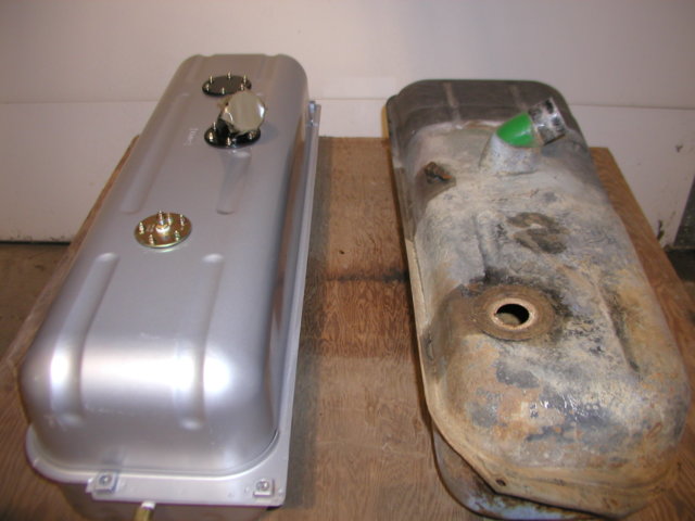

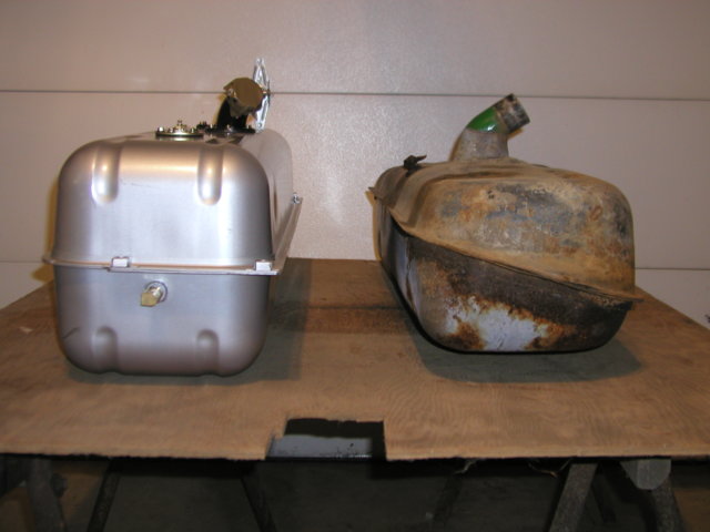

Here are some photos to see the difference between the original B series tank and the replacement tank from a '39-'47 Dodge truck.
This angle shows that the two are somewhat close but not the same. Original is about 3" longer and 2" or 3" shallower than the replacement. Also original is a couple inches wider. The extra depth on the new replacement costs you a few inches ground clearance, but it is still well above the front and rear axles.
The locations of the filler tube and the sending units are close, but again not exactly the same. Both are a few inches farther to the rear of the tank than the original. Therefore, I clocked the filler tube 60 degrees towards the front/driver side instead of mounting it straight to the side like the original. This is what allows me to NOT have to cut the cab floor for clearance as Tanks suggested in their instructions. Since the sending unit is also a couple inches further to the rear, it does not line up with the access hole in the cab floor. I'm OK with that, I'll just have to drop the tank if I ever need to get to the sender at a later date.
Here again you can see the difference in the orientation of the filler tube on the new versus old.
Probably the biggest difference is the "mounting flange". Original is at a "diagonal" whereas the replacement is "horizontal". Also the dimension between the two mounting holes on each end is not the same, TanksInc statement that the front can be "bolted right up" to the original mounting bracket is false. Also the fuel pickup point is in the front lower portion of the new tank versus the top middle of the old. No biggie since I was replacing all the old fuel line anyway, so the new line is routed accordingly.

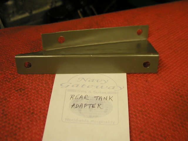

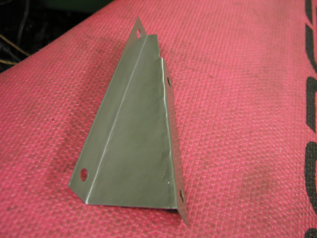

Fabbed up a couple of adapters to hang the tank under the truck in original position. Front and rear brackets are NEAR mirror images but rear is about 1/2" shorter than the front.
