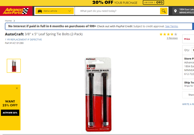

        Polara_500Well-Known Member
        Messages:
        646
        Likes Received:
        400
        Joined:
        Aug 9, 2015
        Location:
        NW Minnesota
        Yep, just went out and looked at some, I was remembering that the bolt fit in the register on the pad, but I was remembering an extended tip vs the round head. Thanks for correcting me.
        Not sure these are the right ones, but AZ has them and NAPA, etc..

          MoparsOnlyThe snozberries taste like snozberries.
          Messages:
          198
          Likes Received:
          48
          Joined:
          Sep 24, 2015
          Location:
          South Carolina
          Thanks for the info Polara
