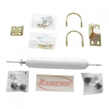

    I looked at the part you got from Summit, the applications listed were all Chevy. That doesn't help, I know.
    Did a quick Google search for a 78 model, I guessed. Came up with some options, but this is what a Dodge kit looks like. It is another brand, but I did it for visual purposes.
    The tab on the left goes to the frame, the tab on the right to the axle. This one is from stockwiseauto.com but I'm sure there are more options. That sucks you got the wrong part, but it can easily be fixed. Let us know how it goes when you get the correct kit.

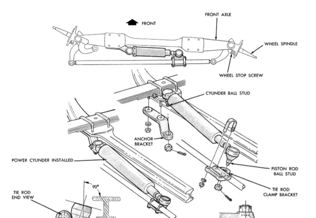

      This may be of some use - I found it in my Supplemental Manual for 1968 trucks;
      Let us know how that looks.

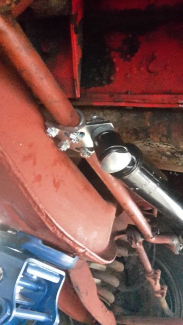

          Good Morning... finally made it ot install that steering damper kit ... here are the pics how its bolted to the frame and the centerlink. Once i figured out how it was supposed to be... it was pretty easy and took only 20 minutes
