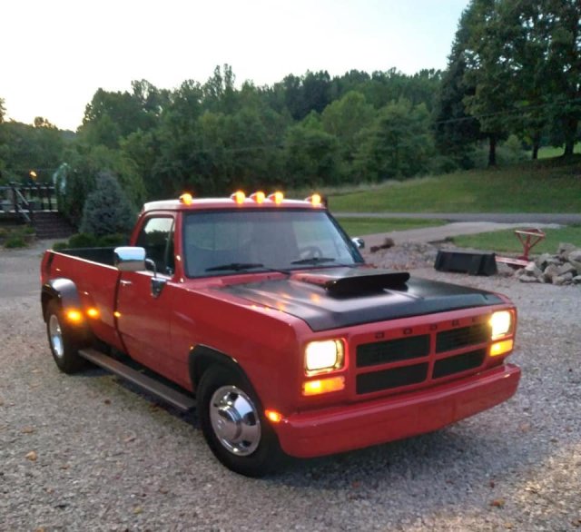

I lowered my 92 1 ton by removing 1 full coil per side, then a bit more on one side to get it level.(don't know why but it sat high on one side) As a general rule of thumb, 1" at the spring =2" at the wheel arch. I can't remember how the 2nd gen suspension is set up, I was thinking it had torsion bars. If it does you can just back them off or adjust them back up till you get what you want. Nothing is ever as easy as it is in our heads though. A pic of my 92.

Love the picture. Not torsion bar suspension on the front. I wished though. She's coil sprung. I want to have at least 1 lowered truck in my life.
