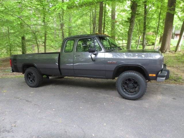

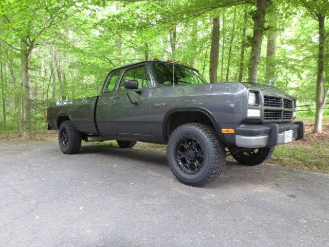

Before and after Pics
First off and I know I've said this before Mitch , But "DAM" that's a nice look'in truck ! :cool: I can understand that you want it to look like a "truck" . ... Now for your issue's . I'm thinking that between the heavy spring that you used and the lift insulator , your just putting to much pressure on your upper control arm . Which in turn is causing premature wear on your bushings and upper ball joints . From what I know as of now , they don't make an adjustable ( or any ) aftermarket control arms for these trucks , or offset bushings . I'm thinking that if you swapped out the springs and got rid of the lift insulators and swapped them out for actual lift springs , that might just do the trick . As a bonus , It might even ride a little better . Just my two cents . :cool:
