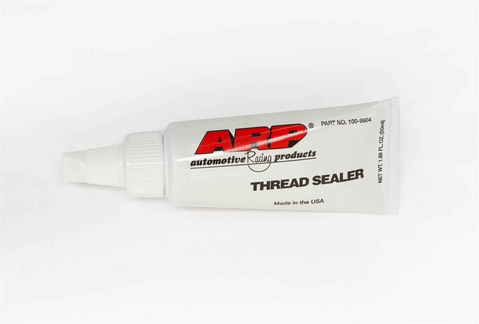

Awhile back i remember reading about someone who hd a leaking header bolt and someone had mentioned a sealer that would stop it, does anyone know what I'm talking about??
I did a search and found a post from someone who recommended Loctite 567. However this is absolutely not the ideal sealant. I am talking about the end exh manifold studs that go into the water jackets. Loctite 567 is not a thread locker and is classed as a low temp (max 150 degrees C) and low...
