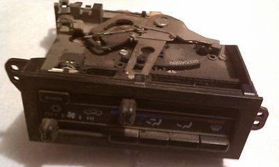

Here are some pics I found
88-96 years your may not look exactly like this but close they did vary a bit between years

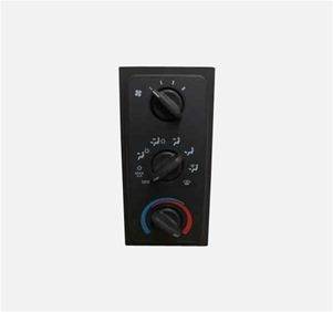

97-03 I think
