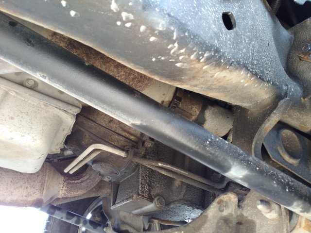

Been looking for something to haul my camper more comfortably than my 1/2 ton GMC. Looking at a 2009 Chevy 2500 long bed work truck with 120 k on it. Former commercial vehicle pulling a gooseneck trailer. Looks okay but concerned about some wet oil underneath. And the sellers anxiousness to sell ASAP.

Is it 2 or 4wd? Is it using a lot of oil? Can you see it dripping when running? Common oil leaks on these trucks are the oil coolers lines, the gasket for the lines on the oil pan, the rear main and gasket for the plate on the rear of the engine.
The drivers side valve cover baffle will plug and not drain and it will suck oil through the PCV system, check this if it's using oil but not leaking bad.
The oil in the picture looks like it's been seeping for a while. I would clean it off and watch it to see how bad and what's leaking.
