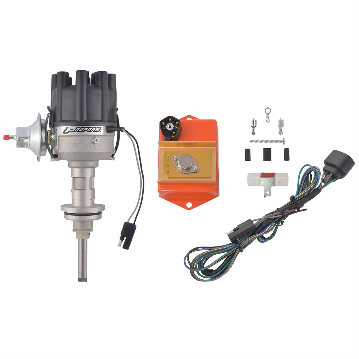

I have an 87 D-250 318 2bbl, 4 speed manual trans. All original! Has NO vacuum advance chamber on distributor. It has an "ECU" box mounted on the inner drivers side fender, with a vacuum advance unit mounted to it, & vacuum hose going to it. (hose has vacuum, like a regular advance set up, at idle) Looks like the older junkie "Lean Burn" set up I had on my 77 Cordoba. I would like some input on getting rid of this lousy system (revs slow, ETC. ETC.) & installing an electronic ignition conversion set up like I did on the Cordoba (35 years ago). Has anyone done this to their truck, or got rid of this type factory ignition system for a better set up? Not sure if it's similar to the Lean Burn system, & I don't want to disable this thing for more than a day, weekend at most. Thanks for ANY info.
I got a Proform kit for my Dart. Did not like it, (JUNK) & will not buy anything from Proform again. I would rather spend extra & buy the Summit Racing kit. But I still don't know if I can install this system without any problems from removing the factory system.

I would not remove it. Just disconnect the distributor and move the vacuum line to the distributor can.
OK, this is the problem I'm having. The factory distributor has NO VACUUM ADVANCE UNIT mounted on the body of the distributor. There is a box on the inner drivers fender, mounted on a bracket that mounts to the inner fender. It has two connectors / electrical plugs going to it, very much like the old Lean Burn units used to have. It also has a vacuum diaphram mounted to it, like a vacuum advance distributor would have. The wires are routed in the wiring harness & some must go to the distributor for advancing the timing through the box mounted on the inner fender. I just need to know if someone has done this specific upgrade to their truck. I don't want to disable this thing too long. Can I by-pass the factory "Ignition Advance" box with a Mopar Performance type ignition conversion kit?
You can but will be a pain in the you know what compared to the single ignition wire distributor that only needs and IGN 1 & 2 wire feed. On the vacuum line disconnect it at the computer advance and connect it to the new distributor. Why make this more complicated than it needs to be?

The factory system you have I believe the last of a lean burn style system. I did some looking and prices are all over for the HEI depending on where you order from, summit or cheap e-bay China built units. I do like the HEI, like 7mopar said very simple and parts are everywhere. You can build your own HEI if you have a electronic vacuum advance Mopar distributor.

Ive done away with a few of those, most recently my 85 /6 truck. youll need the 4 pin ECU, a ballast resistor, a vac advance distributor and a carb with the ported fitting to run the vac advance can.
