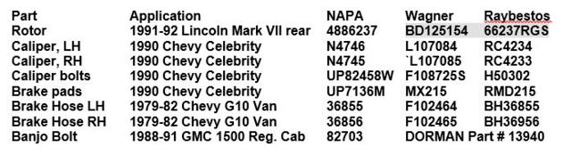

No...here is the list of parts on top of the Scarebird branded backing plates and banjo bolts.....
