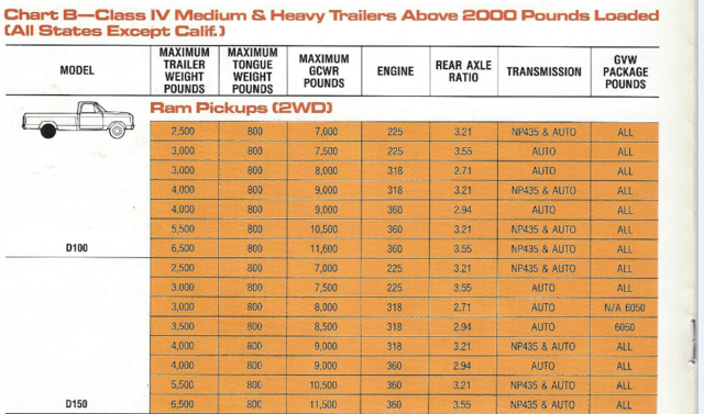

Hi 7mopar, thank you for your answer but I think you talk about Curb Weight not GCWR. In France we have the PTAC (Poids total autorise en charge) which has the same definition of your GVWR (Gross vehicle weight rating) and we have the PTRA (Poids total roulant autorise) corresponding to your GCWR (Gross combined weight rating). You and I can't simply weight it with a scale because this is the combined maximum weight limit that the manufacturer has set for the two vehicles once attached. As I want to tow with my D100 this value has to be written on my french title. That's why I am looking for it. I found this document for bigger truck but nothing for D100
I have seen it for smaller trucks posted on this site I think.
Away it does exist.
1986 version, I think I have a 77 owner's manual but can't put my hands on it right now.
Thank you Polora_500 for this document. It is not the same year but I think I can use these values. My D100 has a 360 engine and a manual transmission with a 3.21 rear axle ratio so the GCWR should be 10500lbs.
