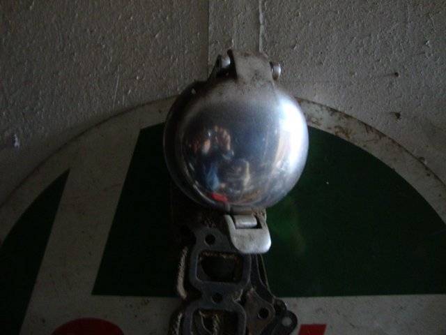

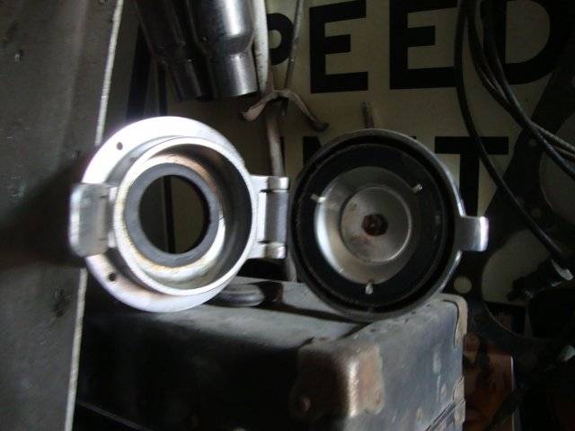

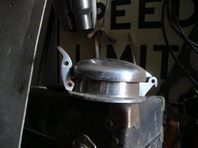

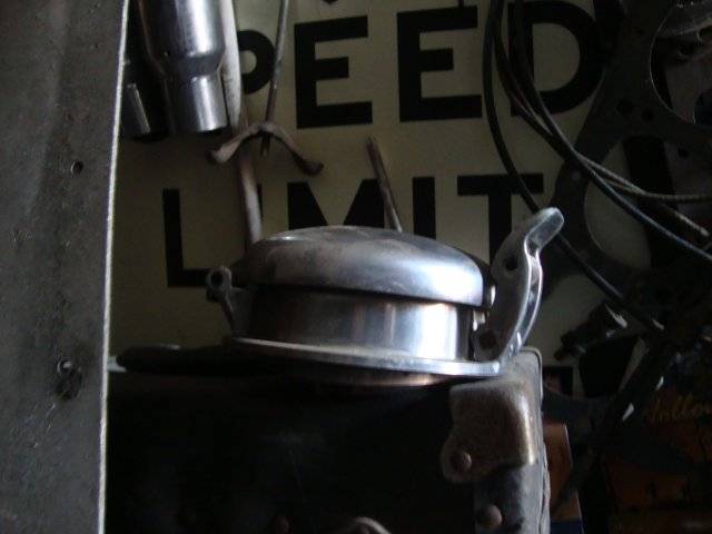

what about a viper cap assembly , looking for a reason to put this on . as you can see , it ate small . lol .
That would work. The only thing you would need to do is if you recess it you need to make a little drain hole for rain but, it will most definitely work and be totally cool.
Hey one other thing is make sure the gasket fully seals. I've worked on a few Jag's xjs with the pop up filler that have had the seal go bad and, they would get water and other trash into the fuel system.
